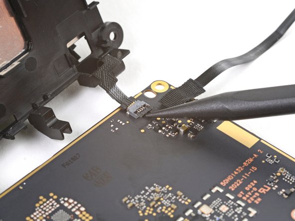

Disconnect the power button
  • Use the point of a spudger to lift of the locking flap on the power button ZIF connector.
