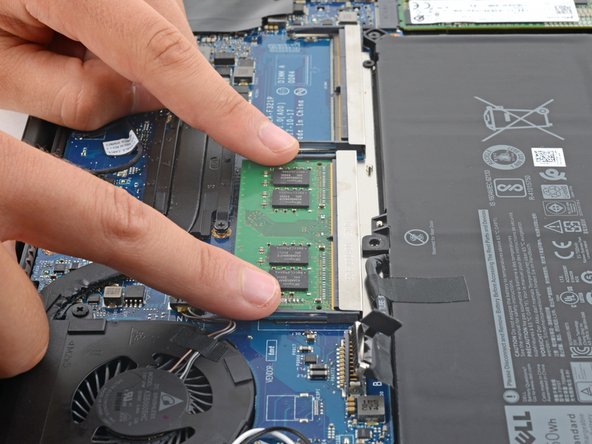

Remove the RAM
  • Two metal arms secure the left and right edges of each RAM module.
  • Simultaneously push the arms outward to disengage them.
  • The module should pop up at a slight angle.
  • Remove the RAM module.
  • Repeat the process for the second RAM module.
  • To install a RAM module, insert it into its socket at a slight downward angle and push down firmly until both metal arms lock the module in place.
