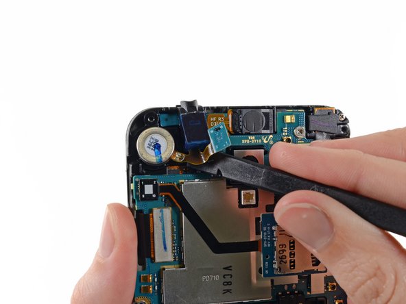

  • Use the flat end of a spudger to release the headphone jack from the adhesive securing it to the midframe.
