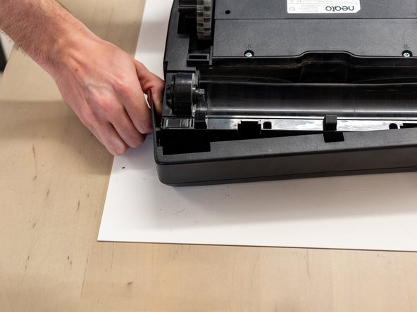

  • Pull one side of the front bumper out and then forward toward you. Repeat on the other side to completely detach the front bumper.
