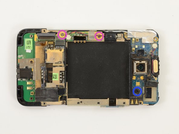

  • Remove one 1.5mm #00 Phillips screw.
  • Remove two 2.5mm T5 torx screws.
