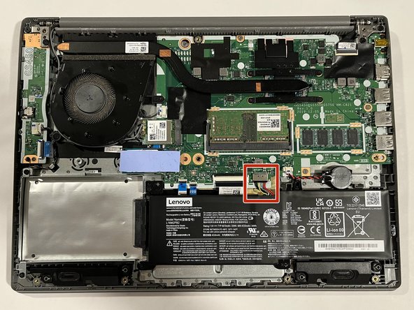

  • Use your fingernail or an opening tool to gently pull out and disconnect the battery pack cable.
  • Do not pull on the cables.
