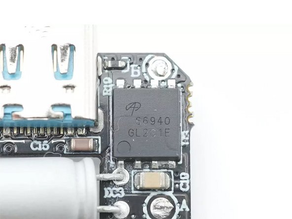

Internal display 7
  • Synchronous rectification MOS tube screen printing 66940, from AOS Bandai.
  • The output filter capacitor is from YMIN, NPX series solid capacitor, the specification is 470μF 25V.
  • The USB PD fast charging protocol chip adopts Infineon CYPD3174, which supports PD3.0 including PPS protocol, QC4.0, Apple 2.4A and other fast charging protocols; built-in multiple comprehensive protection functions, built-in 32-bit M0 processor, Integrated oscillator and no external clock required.
  • Weld an NTC thermistor on the left side of CYPD3174 to detect the internal temperature of the USB-C socket and the charger to realize the live protection function.
