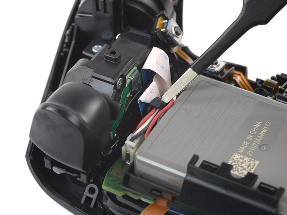

Free the battery connector cables
  • The battery connector cables are routed underneath a small plastic hook next to the battery connector.
  • Use tweezers to carefully pull all three battery cables out from under their plastic hook.
  • During reassembly, make sure to thread the cables back underneath the plastic hook.
