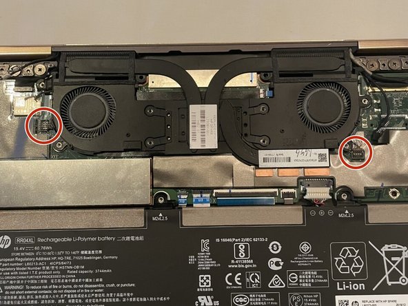

  • Disconnect the two fan cables using a small pry tool.
  • Be sure not to rip the wires, as they are fragile. It may help to slightly pry on the fans while disconnecting the wires, so the pry bar has enough room.
