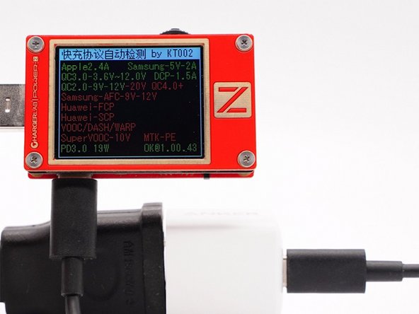

Charging protocol test
  • Using ChargerLAB POWER-Z KT002 to detect the output protocol of the USB-C port, it shows that it supports Apple 2.4A, Samsung 5V/2A and DCP protocols, as well as QC2.0, QC3.0, PD3.0 fast charging protocols.
  • In addition, its PDO message shows that the USB-C port has two sets of fixed voltage levels of 5V3A and 9V2.22A.
