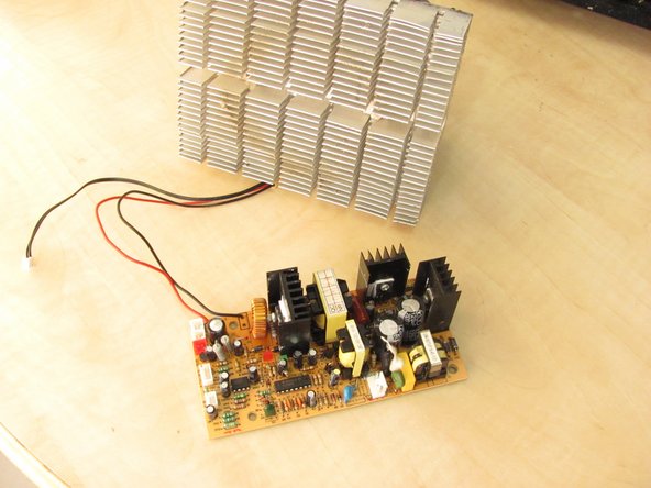

  • The heat sink and motherboard are removed. Yay!
  • The Vinotemp VT-12TEDi has a very high rate of capacitor failure on the motherboard. Before buying a new motherboard:
  • Check for capacitor failure.
  • Learn how to solder and replace the broken capacitor yourself.
