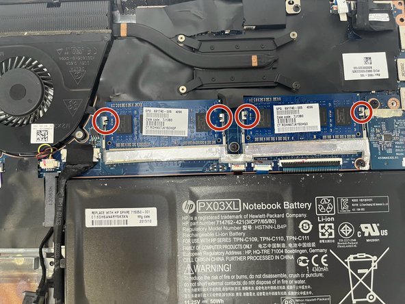

  • Gently press on the clips located on either side of the RAM stick.
  • Press downward on the clips until you feel the RAM stick start to come loose.
  • Do not try to pull the chip out without moving the clips first. This could potentially damage them.
  • The RAM stick will pop out. Carefully pull it free to remove it from the laptop.
