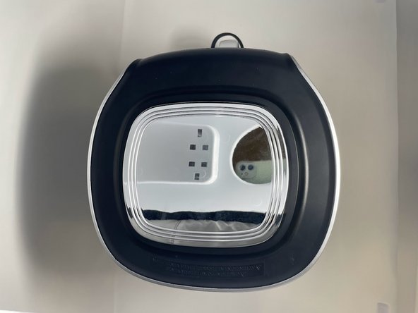

  • Use the a plastic opening tool or a similar object to wedge between the silver top and black rim.
  • Pry all four sides towards the middle with a plastic opening tool to release the tabs.
  • The tabs on the top will make sounds while being detached from the device.
