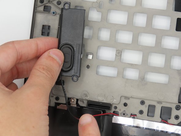

  • Remove the screws using a Phillips screwdriver and pull the speakers from the body.
  • There may be tape to secure the cables to the shell of the computer. It is okay to remove it but should be saved for the new speakers.
