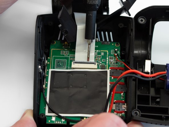

  • Using the Flathead 1.5mm screwdriver, or another pry tool, gently flip up the black ZIF connector locking flap to free the ribbon cable.
  • Once the connector is open, slide the ribbon cable out to remove it.
