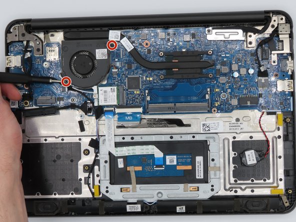

  • Remove the two 5 mm screws from the fan using a Phillips #0 screwdriver.
