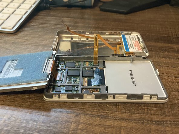

Pry the frontplate off of the frame that holds the motherboard
  • Using a spudger or pick, gently pry the frontplate off of the iPod's frame that holds internals such as the screen, motherboard, etc.
  • Your iPod should look like the second image when this step is completed.
