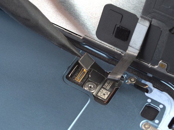

Disconnect the front sensor cable
  • Use the pointed end of a spudger to disconnect the front sensor cable by prying the connector straight up from its socket.
Usa el extremo puntiagudo de un spudger para desconectar el cable del sensor frontal levantando el conector del zócalo.
