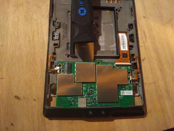

Remove the board
  • The board has no more screws left, but it is still glued to the casing
  • Use some more heat to weaken the glue
  • Lever the board to unglue
  • Then, remove it by sliding it out
