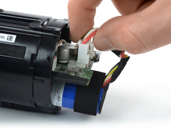

Disconnect the battery
  • Squeeze the tab against the power cable connector, and pull the connector straight up from its socket to disconnect the battery.
