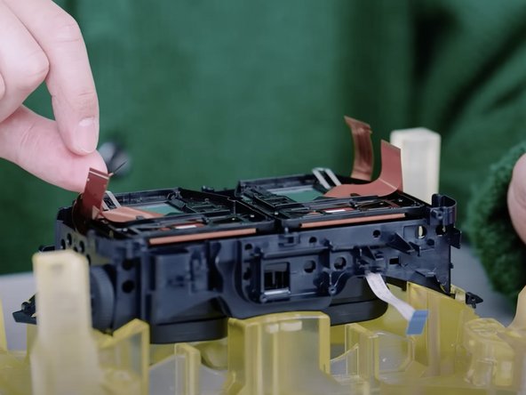

  • Work can begin for removing the Optical Unit. We can start by removing the springs for the depth of the lenses.
  • We can also remove the dial for the horizontal lens movement. This is easy removed with a Philips head screwdriver. Once taken off we can simply slide the metal rod out.
