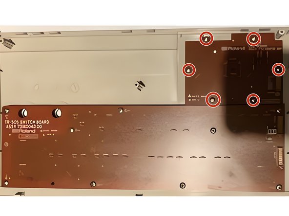

Disassembling the top half
  • with the connectors disconnected you can lift the top half away.
  • to take the LCD out, take out these PH 1 Philips screws
