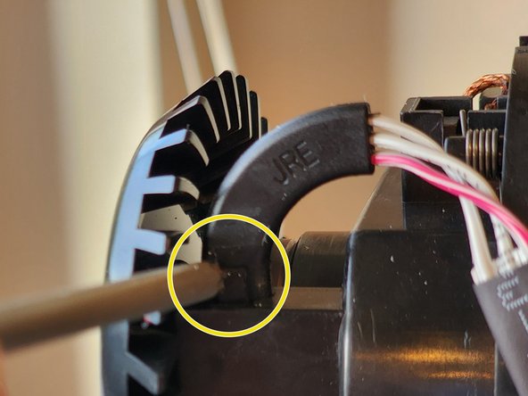

Commercial 8 Quart Bowl-Lift Stand Mixer - Bowl-Lift Arm Adjusting Bracket Replacement, Remove the hall effect sensor and powertrain/motor: crwdns2935265:00crwdnd2935265:01crwdnd2935265:02crwdne2935265:0 Commercial 8 Quart Bowl-Lift Stand Mixer - Bowl-Lift Arm Adjusting Bracket Replacement, Remove the hall effect sensor and powertrain/motor: crwdns2935265:00crwdnd2935265:02crwdnd2935265:02crwdne2935265:0
  • Remove the hall effect sensor from its mount by pressing down on the tab indicated in the first image and sliding it out.
  • Now that the powertrain/motor is fully disconnected from the mixer, remove it and place it to the side.
  • Take care to protect the powertrain/motor, especially the plastic fan at the rear, as damage to any part of the motor/powertrain (including said fan) will require replacement of the entire unit.
