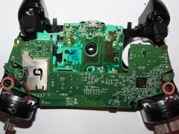

  • Using a TR6 Torx screwdriver, remove the two screws on the top motherboard and unclip it.
  • Be very careful after removing the screws from the top motherboard panel. While de-soldering is not required, you still must be careful to not damage the wires for the rest of the repair.
  • After unclipping the top motherboard, the 3.5 mm audio jack piece will fall out. Set this aside for the reassembly of the controller.
