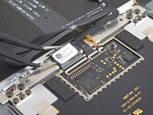

  • Light adhesive secures the two black ribbon cables to the touchpad bracket.
  • Slide one arm of your angled tweezers under the wider ribbon cable and gently lift to separate the adhesive securing it to the touchpad bracket.
  • Repeat for the middle ribbon cable to separate the adhesive.
