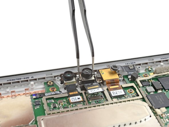

Microsoft Surface Pro 4 Front Camera Replacement, Remove the front camera: crwdns2935265:00crwdnd2935265:01crwdnd2935265:02crwdne2935265:0 Microsoft Surface Pro 4 Front Camera Replacement, Remove the front camera: crwdns2935265:00crwdnd2935265:02crwdnd2935265:02crwdne2935265:0
  • Remove the iOpener.
  • Turn your device back over.
  • Use tweezers or your fingers to remove the front camera.
  • During reassembly, you can either reuse the residual adhesive or clean it with highly-concentrated isopropyl alcohol (over 90%) and install new adhesive.
