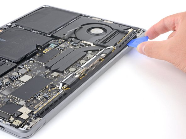

MacBook Pro 13" 2022 (M2) Antenna Bar Replacement, Pry up the antenna bar: crwdns2935265:00crwdnd2935265:01crwdnd2935265:03crwdne2935265:0 MacBook Pro 13" 2022 (M2) Antenna Bar Replacement, Pry up the antenna bar: crwdns2935265:00crwdnd2935265:02crwdnd2935265:03crwdne2935265:0 MacBook Pro 13" 2022 (M2) Antenna Bar Replacement, Pry up the antenna bar: crwdns2935265:00crwdnd2935265:03crwdnd2935265:03crwdne2935265:0
  • Insert your opening pick between the antenna bar and the frame.
  • Pry at different spots along the length of the antenna bar to free it from its recess in the frame.
  • Don't slide your pick, as it may damage display cables underneath the antenna bar.
