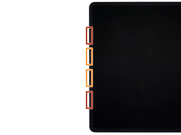

iPad Pro 12.9" 5th Gen Opening Procedure, Left edge information: crwdns2935265:00crwdnd2935265:01crwdnd2935265:02crwdne2935265:0 iPad Pro 12.9" 5th Gen Opening Procedure, Left edge information: crwdns2935265:00crwdnd2935265:02crwdnd2935265:02crwdne2935265:0
  • There are four cutouts for flex cables along the left edge of the screen where the adhesive is very thin. Don’t insert your opening pick more than 2 mm in these locations to avoid damaging the display:
  • The 2.1-cm outer cutouts begin at 6.1 cm from the top and bottom of the frame.
  • The 2.8-cm inner cutouts begin at 10.1 cm from the top and bottom of the frame.
  • Everywhere else, don't insert your opening pick more than 5 mm.
