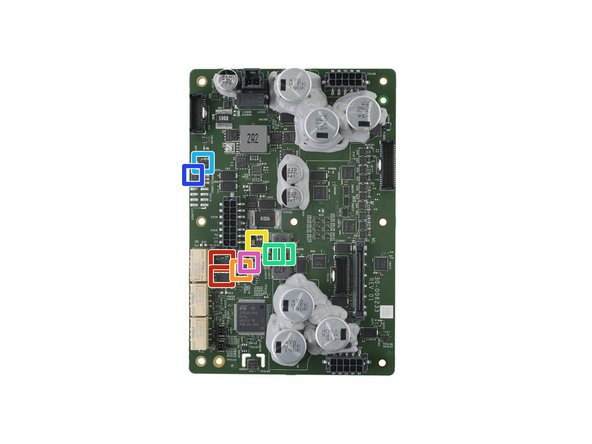

  • Chip ID, part 2:
  • Texas Instruments TPS24750 12 A eFuse w/ current monitor
  • Texas Instruments TPS60400 60 mA charge pump voltage inverter
  • Monolithic Power Systems MP8756 6 A synchronous step-down converter
  • Texas Instruments LM5166 500 mA synchronous buck converter
  • Silergy DC-DC converter
  • Vishay SiP32430 load switch
  • Silergy load switch (likely)
