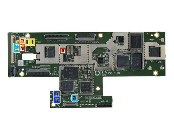

  • Chip ID, part 3:
  • Silergy SY6287C power distribution switch
  • Texas Instruments INA219A 12-bit current/voltage/power monitor
  • Nexperia 74HC4051 8-ch analog multiplexer/demultiplexer
  • Nexperia 74AUP1G02 single 2-input NOR gate
  • Nexperia 74LVC1G08 single 2-input AND gate
  • onsemi ESD8704MUTAG 4-ch. ESD protection diode array
