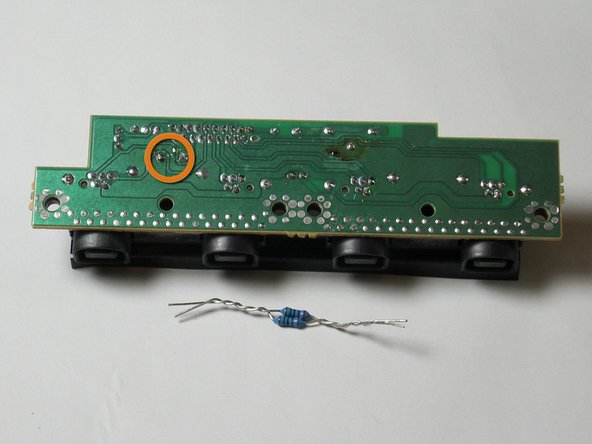

  • If you have already used a fuse resistor to complete the previous step, you may omit this step.
  • Insert and solder the parallel 10 ohm 1/4 watt resistors to the F1 socket.
  • The resistors should be laid out on the top side of the circuit board and the leads should poke out from the underside. The orientation of the resistor does not matter.
  • The 1/4 watt resistors shown in the picture are used to depict what parallel resistors should look like.
