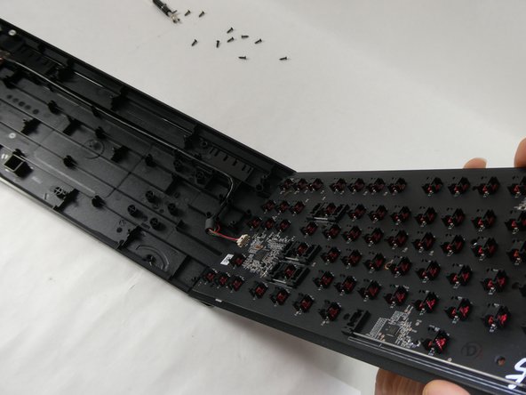

  • Gently lift the front panel off.
  • The front panel should be connected to the USB board. Do not tug the panel off as this may damage other parts.
