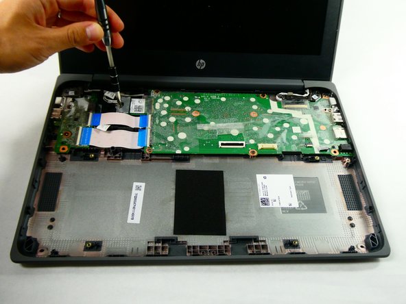

  • Unscrew the single screw securing the Wi-Fi card/cover using a Phillips #1 screwdriver.
  • Remove wireless antenna cables from the module using tweezers.
  • Pull the Wi-Fi card out from its motherboard port using tweezers.
