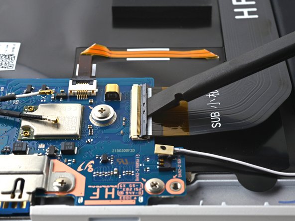

Disconnect the interconnect cable
  • Use a spudger to gently pry up the locking flap on the daughterboard ZIF connector for the interconnect cable.
