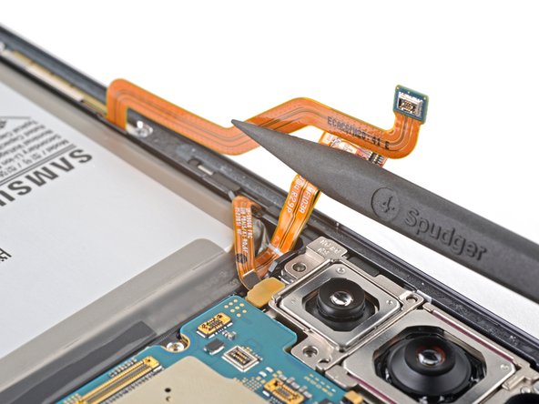

  • Reposition the battery and mmWave antenna cables to access the volume and power button press connector underneath.
  • Use the pointed end of your spudger to disconnect the volume and power buttons.
