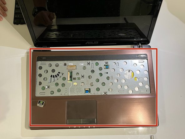

  • Turn the laptop back over so that you can open it.
  • Gently separate the cover from the laptop by putting an opening tool between the cover and the lower part of the laptop.
