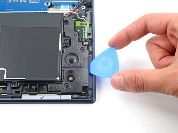

Remove the speaker
  • Insert an opening pick between the bottom right speaker's right edge and the frame.
  • Pry up with the opening pick to dislodge the speaker from its recess.
  • Remove the speaker.
