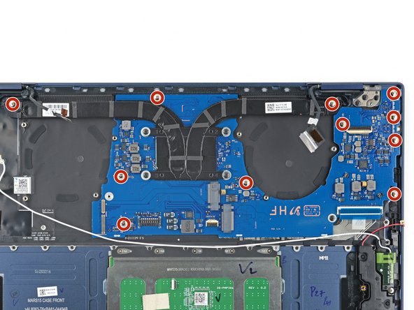

  • Use a Phillips screwdriver to remove the 11 3.5 mm screws securing the motherboard.
