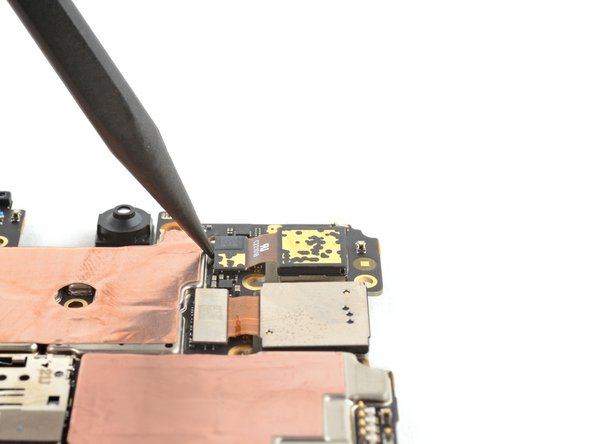

Remove the macro camera
  • Flip the motherboard over so the rear cameras are faced down.
  • Use the point of a spudger to pry and disconnect the macro camera's press connector.
  • The camera may eject from the motherboard. Work slowly to avoid losing it.
  • Use a pair of tweezers or your fingers to grab and remove the camera.
