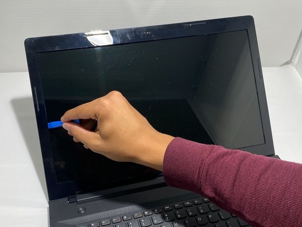

  • Pry open the plastic casing surrounding the screen with the opening tool.
  • You will hear loud popping noises as you separate the plastic casing from the screen.
  • Pull the plastic casing toward yourself and separate it from the screen.
