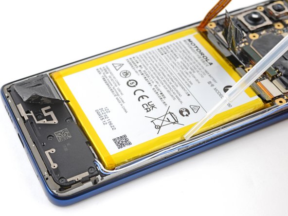

Motorola Edge 5G UW (2022) Battery Replacement, Apply isopropyl alcohol: crwdns2935265:00crwdnd2935265:01crwdnd2935265:02crwdne2935265:0 Motorola Edge 5G UW (2022) Battery Replacement, Apply isopropyl alcohol: crwdns2935265:00crwdnd2935265:02crwdnd2935265:02crwdne2935265:0
  • Apply a few drops of high-concentration (90% or higher) isopropyl alcohol to the gaps along the battery's edges.
  • Tilt the device as you apply alcohol to help it flow under the battery.
  • Wait one minute to allow the isopropyl alcohol to penetrate the adhesive.
  • Only apply a few drops initially and apply more as necessary. If you apply too much alcohol, it may overflow onto the motherboard and daughterboard.
