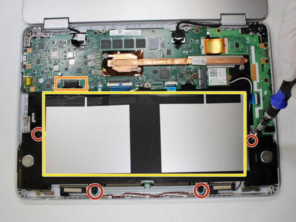

  • Remove the four 2.5 mm screws securing the battery
  • Remove the connector from the motherboard by pulling straight up on it.
  • Carefully lift the battery out of the laptop.
