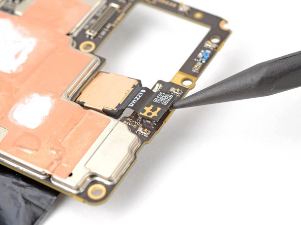

  • Use the pointed end of a spudger to pry up and disconnect the ultra wide camera's press connector.
  • There's no adhesive securing the ultra wide camera to the motherboard. Be careful disconnecting the press connector, as it may eject the camera.
  • Remove the camera.
