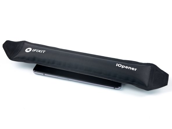

Heat the screen
  • Heat an iOpener and apply it to the screen for two minutes.
  • A hair dryer, heat gun, or hot plate may also be used, but be careful not to overheat the phone—the display and internal battery are both susceptible to heat damage.
