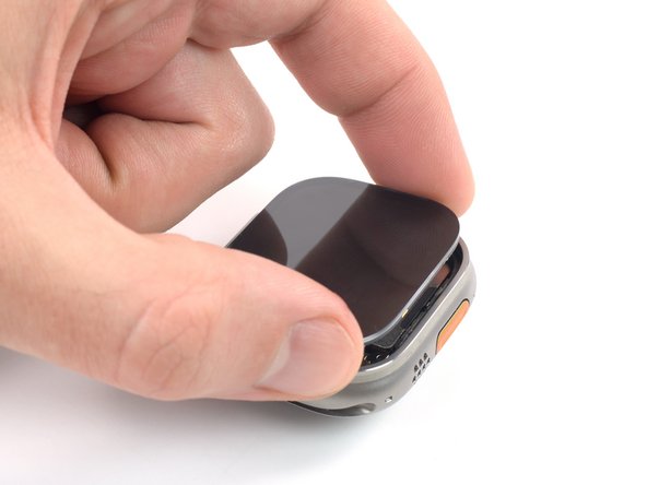

How to Open Your Apple Watch Ultra, Swing open the screen: crwdns2935265:00crwdnd2935265:01crwdnd2935265:03crwdne2935265:0 How to Open Your Apple Watch Ultra, Swing open the screen: crwdns2935265:00crwdnd2935265:02crwdnd2935265:03crwdne2935265:0 How to Open Your Apple Watch Ultra, Swing open the screen: crwdns2935265:00crwdnd2935265:03crwdnd2935265:03crwdne2935265:0
  • Be careful not to strain the screen cable when you swing open the screen.
  • Lift the screen up and carefully pull it towards the Digital Crown.
  • Swing the screen open to an upward position.
