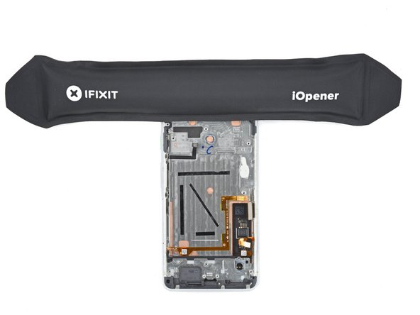

Google Pixel 3 XL Screen Assembly Replacement, Heat the earpiece speaker: crwdns2935265:00crwdnd2935265:01crwdnd2935265:01crwdne2935265:0
  • The earpiece speaker is lightly adhered to the frame.
  • Heat an iOpener and apply it to the top edge of the device for two minutes.
