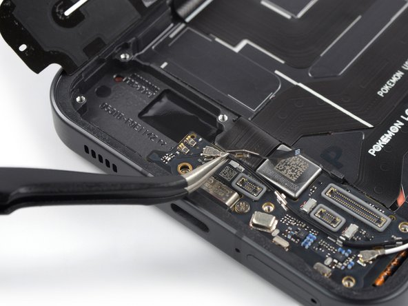

Disconnect the black antenna cable
  • Slide a pair of tweezers under the black coaxial cable until they're snug against the metal connector.
  • Disconnect the black coaxial cable by prying it straight up from the daughterboard.
  • Use your tweezers to carefully loosen the cable from its routing on the daughterboard and bend it to the side.
