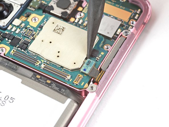

Disconnect the right 5G mmWave antenna
  • Use a spudger to pry up and disconnect the right 5G mmWave antenna's press connector.
