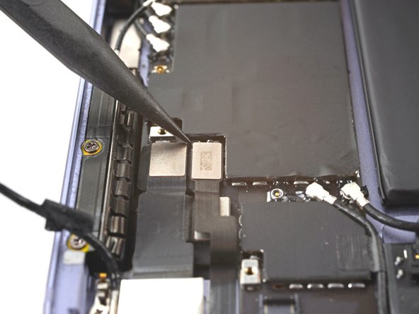

Disconnect the power button board
  • Use the tip of a spudger to pry up and disconnect the power button board's press connector.
