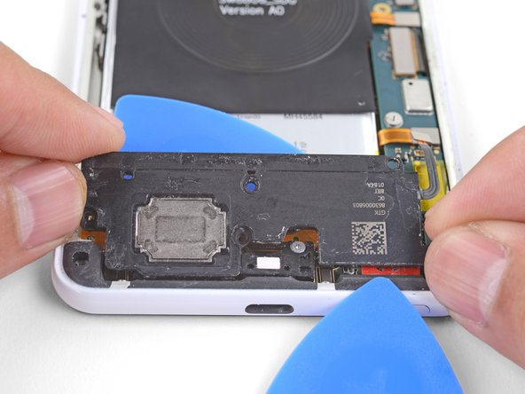

Google Pixel 3 XL Charging Assembly Replacement, Remove the loudspeaker: crwdns2935265:00crwdnd2935265:01crwdnd2935265:02crwdne2935265:0 Google Pixel 3 XL Charging Assembly Replacement, Remove the loudspeaker: crwdns2935265:00crwdnd2935265:02crwdnd2935265:02crwdne2935265:0
  • Lift the loudspeaker out slowly and pull it away from any remaining adhesive.
  • Remove the loudspeaker.
  • Before you reinstall the loudspeaker, you may want to remove any residual adhesive from the frame and place new adhesive.
